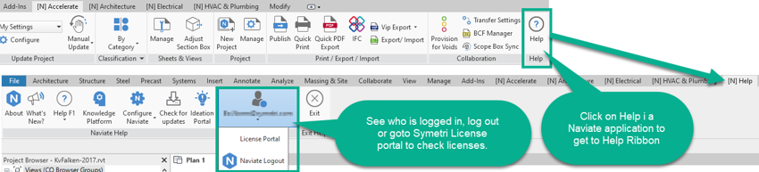

You can see who is logged in to Naviate and also log out from the Help ribbon. You activate the Help ribbon from the Help button in each application ribbon.

The Symetri Licence portal is a web application that you can start from Help ribbon in Naviate or by using the link: https://license.symetri.com. Use your Symetri User ID to sign in.
